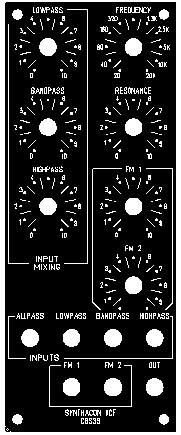

A few ideas for graphics enhancements are shown on a prototype Schaeffer
panel, GIF image located here:
http://www.wavemakers-synth.com/motm/synthacon_vcf.gif . I would have
rounded the corners on the white outlines, but Schaeffer's panel drawing
program won't let you do this. To me this is a bit less severe that the
sharp corners. Adding simple sections visually distinguishes this module
from others. This also shows an alternate tick mark scheme for knobs
that is easier to scope: thin lines between small dots. One final
recommendation, real parameters such as frequencies in Hertz for those
controls where it makes sense. For a VCA and modulation controls, the
standard 0 to 10 marking is the most common, however.
