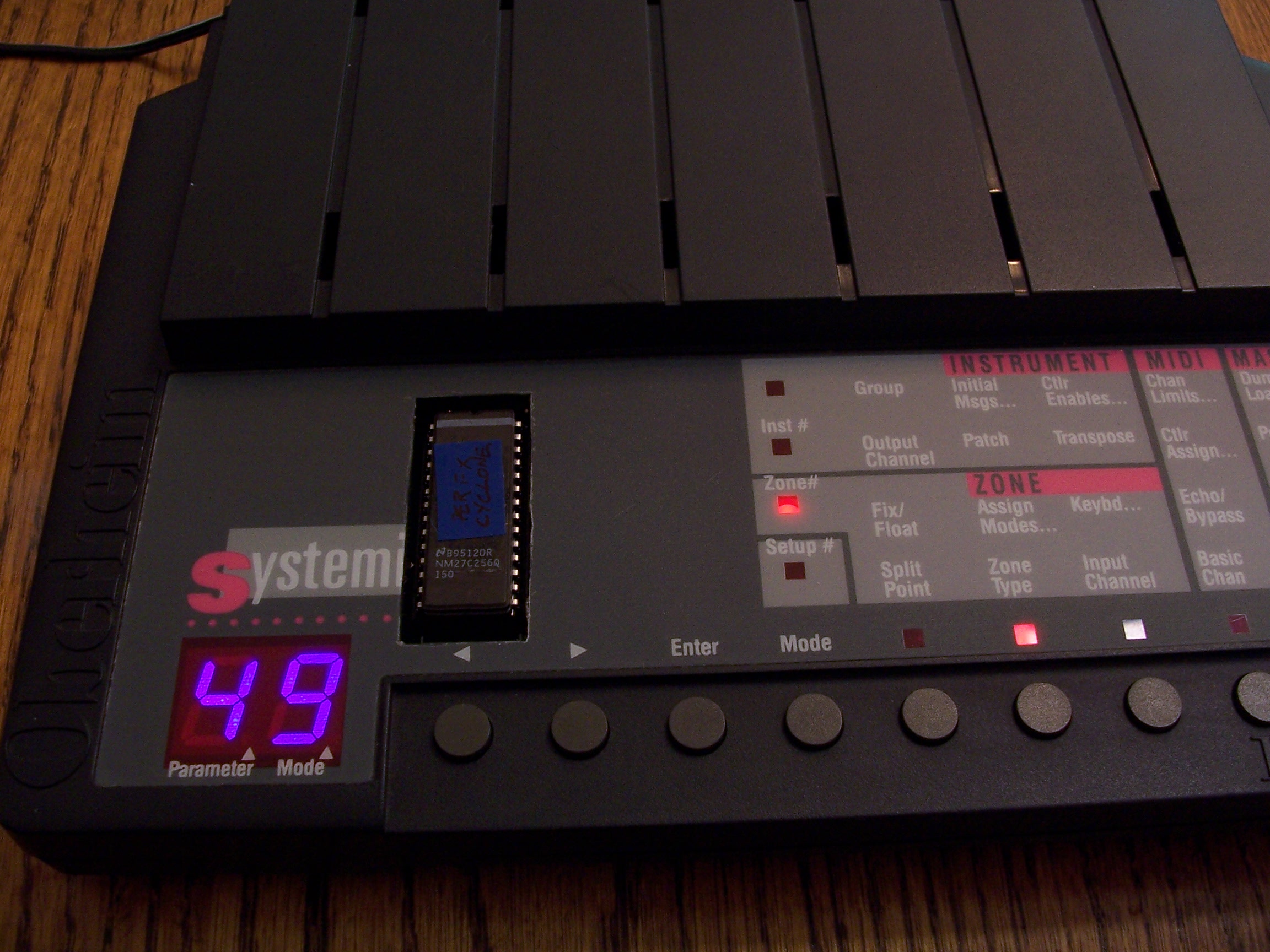

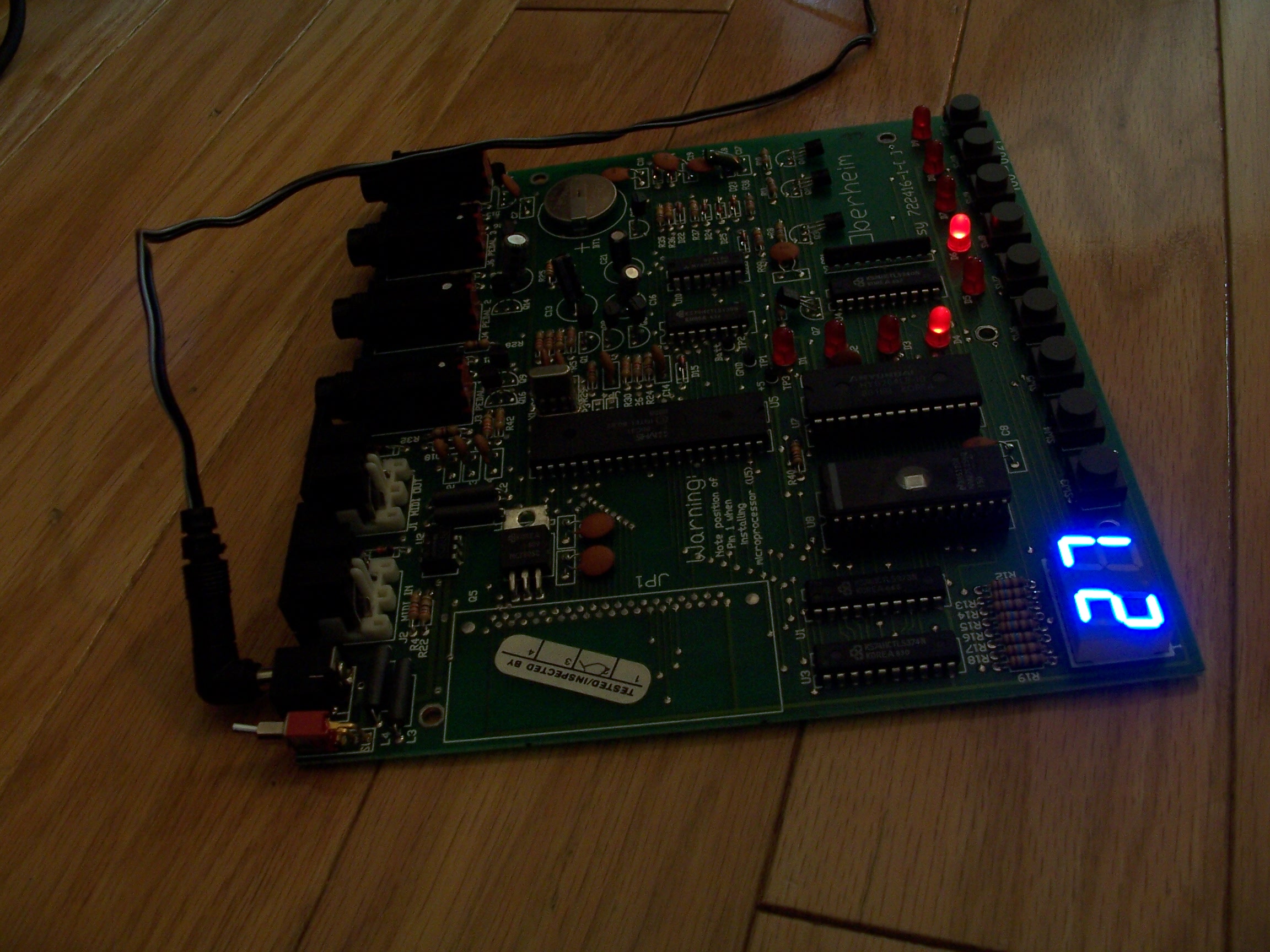

Oberheim left this bloody thing wide open, merely obscured by thin plastic film so...
If you ever get one of these the ROM's are interchangeable, mine came as Systemizer but for now is a Cyclone
