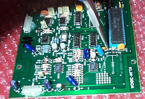

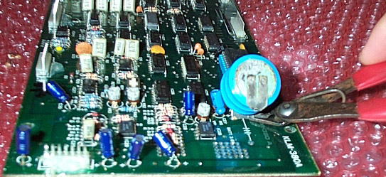

Remove dead cell:
http://www.oldcrows.net/~oldcrow/synth/korg/tri_mkii/tm2_clip2.jpg

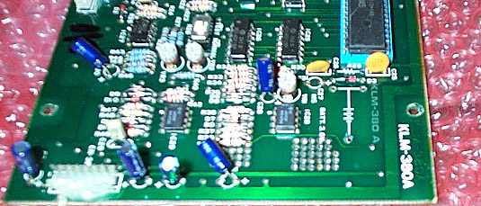

Remove R29:
http://www.oldcrows.net/~oldcrow/synth/korg/tri_mkii/tm2_r29.jpg
Remove C27:
http://www.oldcrows.net/~oldcrow/synth/korg/tri_mkii/tm2_c27.jpg

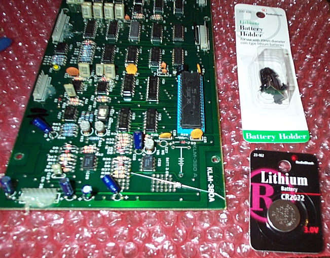

Get some new parts:
http://www.oldcrows.net/~oldcrow/synth/korg/tri_mkii/tm2_newparts.jpg

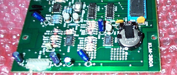

Solder the diode and socket in, and pop in the coin cell:
http://www.oldcrows.net/~oldcrow/synth/korg/tri_mkii/tm2_newbatt.jpg
The diode's band (cathode) should connect to the other diode's cathode
when mounted in the R29 position correctly.
