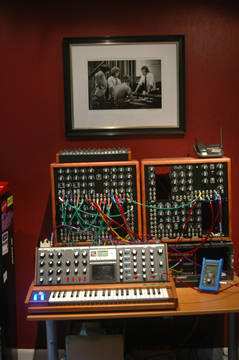

i have not used the MOTM specific cases but i did order 2 10 space
boxes that i use for my rig. here's a pic:
http://cedub.com/homepage/images/synth.jpg
i also bought 2 of the standard slant racks for my outboard gear but i
don't have a good picture of those handy. i'm a big fan of this guy.
quality construction and the price is right. he'll also do whatever
custom work you want. i had him add mounting rails on the back for my
power supplies.

> I had to learn from others too. I was told to use spray-on rubber
cement to
> attach the Tolex, so that's what I used. I learned through
experience that
> it really needs to be applied to both the Tolex and the wood,
otherwise even
> though it may seem secure at first, it will usually start peeling
off along
> the edges and air bubbles will start forming underneath in different
places.
> If air bubbles do form a few days after applying the Tolex, I use a
pin to
> poke small invisible holes to let the air out and push that spot
down again.
> My case only uses two separate pieces of Tolex. One piece covers
the top
> and both sides, including curving around the bottom about an inch. Just
> start at one end and slowly and firmly pull the Tolex and apply it
as you
> go. The other piece is for the rest of the bottom. I had to do that
> because of my odd case shape, but that's also how I'd do a regular
rectangle
> case too, as the two seams while visible if you look at the bottom
of the
> case, will be invisible in normal use, because the metal corner
pieces will
> hide them. I can't remember exactly how I cut the corners (probably
cut a
> triangle shape out), but that part will always look a bit sloppy. It
> doesn't matter though, because the metal corner protectors cover all
that up
> so it's not seen.

I bought my case parts and vinyl (Tolex-like covering) from Penn Fabrication
years ago (http://www.penn-elcom.com/). They had a $50 minimum order at
that time, but their prices were cheap compared to the prices Mars Music was
selling Penn Fabrication parts for.

I went ahead and ordered a cabinet from nice-racks. Instead of the wood
rails I had him mount standard rack rails which is the same method I
used on the cabinet I built myself. I'd rather be screwing into metal
than wood. I also got rear rails so I can mount the PSU on the back.
Only issues are
1. You can't use the standard MOTM screw since it's 8-32 and rack is 10-32.
2. With the way the rails are bent there's about 1/8 inch gap at the top
and bottom of the module where you see the rails, but the rails are
black as well so I don't think it's very noticeable.
All in all same quality as any of their other racks. There was no
charge for the modifications, but this was kind of a prototype so not
sure if that will always be the case. I know some listers balked at the
price, but if time = money, it's certainly worth it to me.
