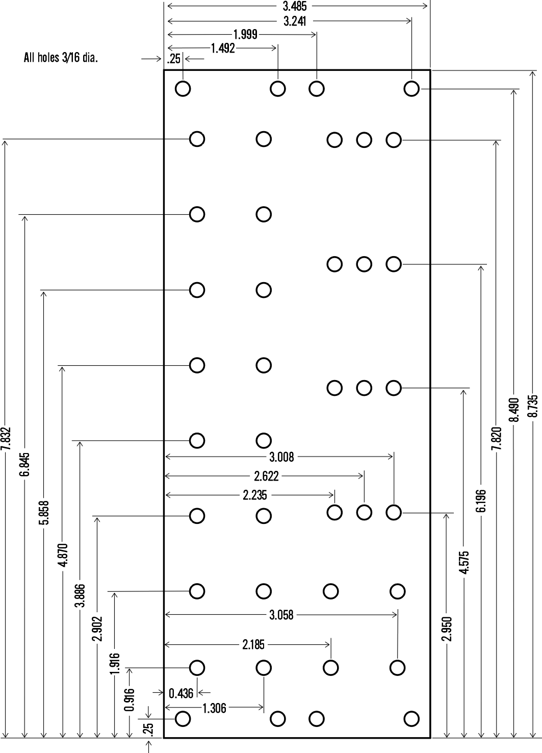

Does anyone have a template showing the standard positioning of MOTM
front panel holes including the rack-rail holes?
I'm building a Super-moe type sequencer and will be drilling all the
holes in old sheet metal before committing to a real panel.

Well, if you measure hole locations from actual panels, the location
varies subtly from design to design. I have a standard grid that I
use when designing Stooge panels, but am at work right now and can't
get to it.
For corner holes, just figure 1/4" in from each edge for the center.

I put the template for the hole spacing which I use @
http://www.hylander.com/images/motm/MOTM-template.gif
