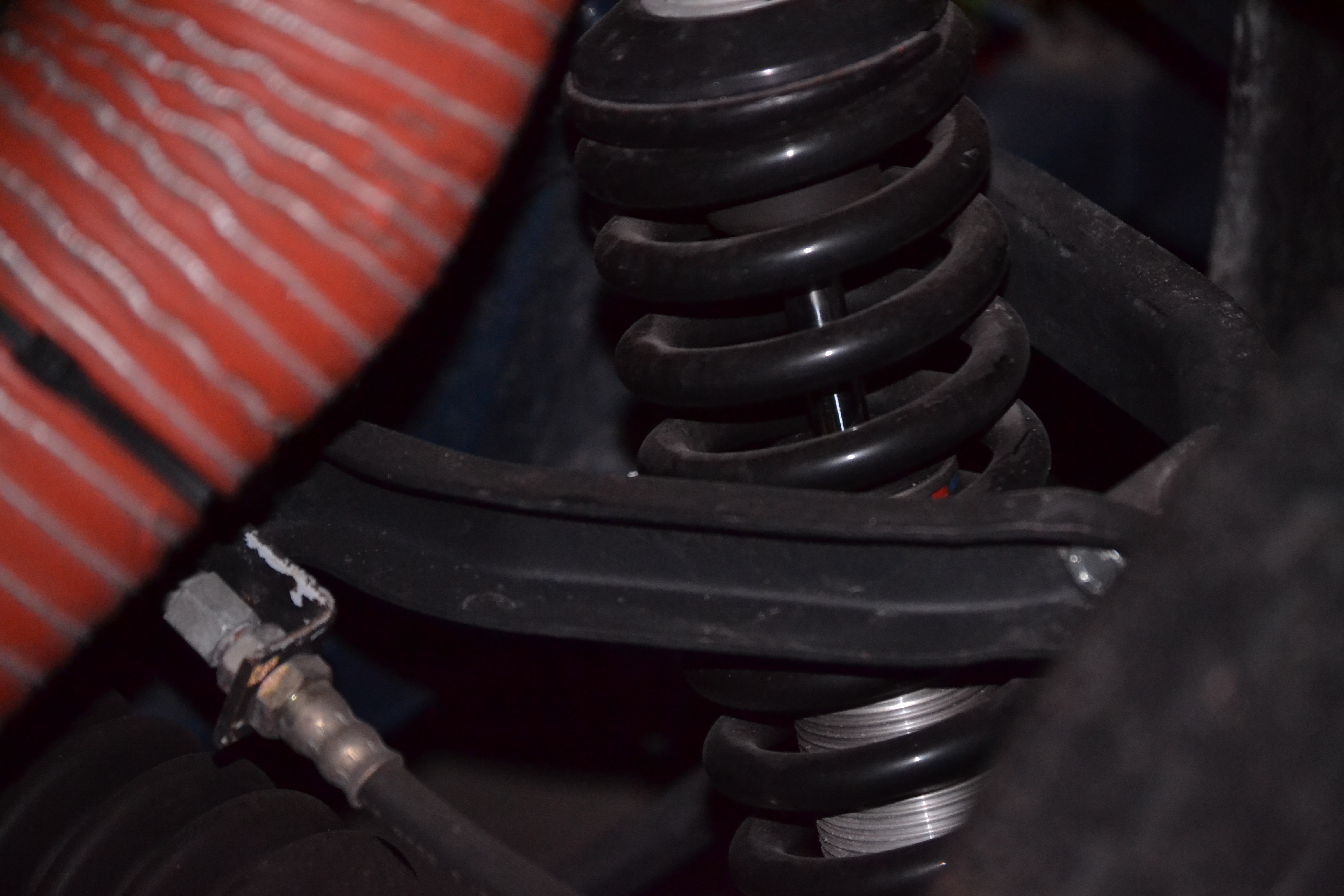

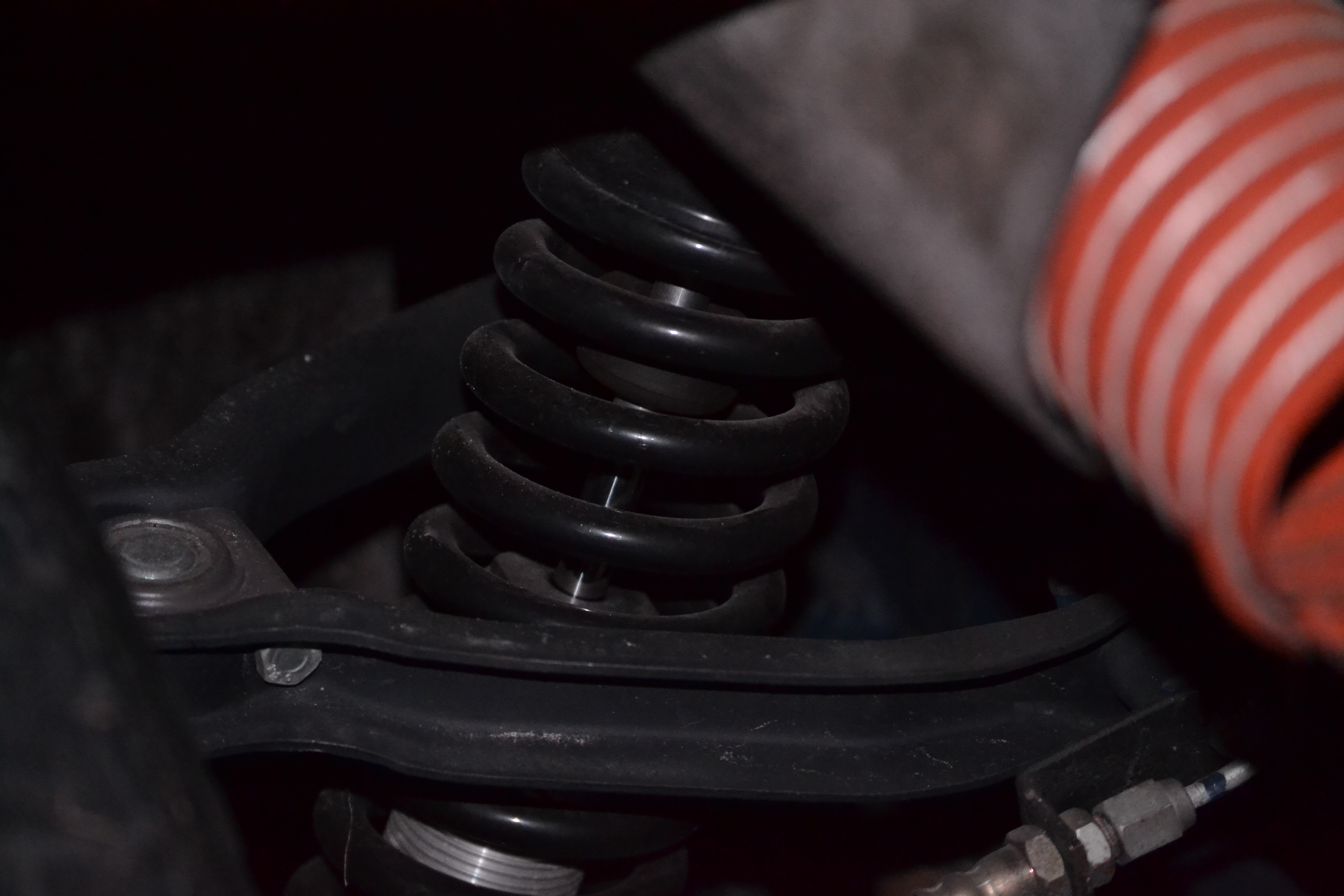

Here's a bit of a mystery hopefully some of the smart ones on the list can
help solve.  After lining up the bonnet on the car and installing the front
suspension, there are major clearance issues.  I sending a long a few
pictures to show how too far to the front the wheel is is the fender
opening.  When pointed straight ahead I can't even insert a finger into the
tightest part of the gap.  And that's without the weight of the engine and
transmission which are still out of the car.  Its so far forward that on
almost full lock, the wheel runs under the headslight housing and trie to
push the hood up.   It was close when I took the car apart 30+ years ago,
but not this bad.  What have I done wrong????  All suggestions for a fix are
most welcome.
Danny

Could you send some pictures of the upper and lower control arms and shock absorbers (both sides)?

Danny,
Check your lower control arms and be sure that there is a triangular tab on the forward arm on left and right sides. This is a mounting point for a stabilizer bar used on the Triumph but the Marcos only used the bar on racing cars and not street cars. It must be on the forward arm to locate the wheels in the correct location.
The 2 pics are the best I can do without removing the wheel liner. the1st is the left side from the front lookong aft and the other is the right side.
You might not be able to see what I am trying to show you and my car is the steel frame 1970, but the attach points are similar.
Best Regards,

Danny,
Also, the arm with the most bend must be in the forward position.

Danny,
I forgot to say that the pictures are of the upper control arm.

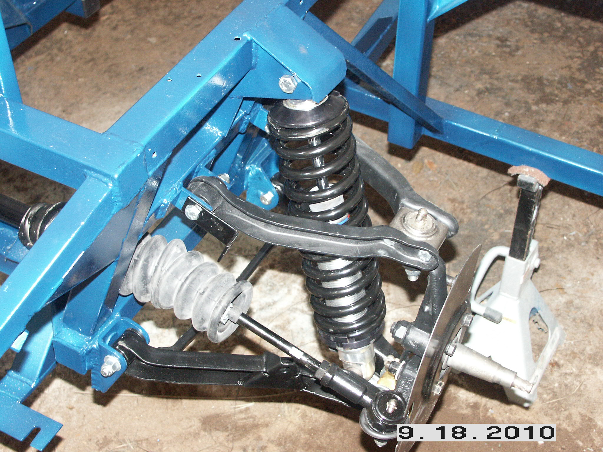

RE: [MarcosManiacs] FW: front wheels clearance issue a6oo gt wooden chassis [2 Attachments]
2013-09-14 by Ron McLeod
Here’s what it should look like – photo from the restoration of my ’70 GT
Regards . . . Ron McLeod

Re: [MarcosManiacs] FW: front wheels clearance issue a6oo gt wooden chassis [1 Attachment]
2013-09-14 by larry meadows
Thanks, Ron.
