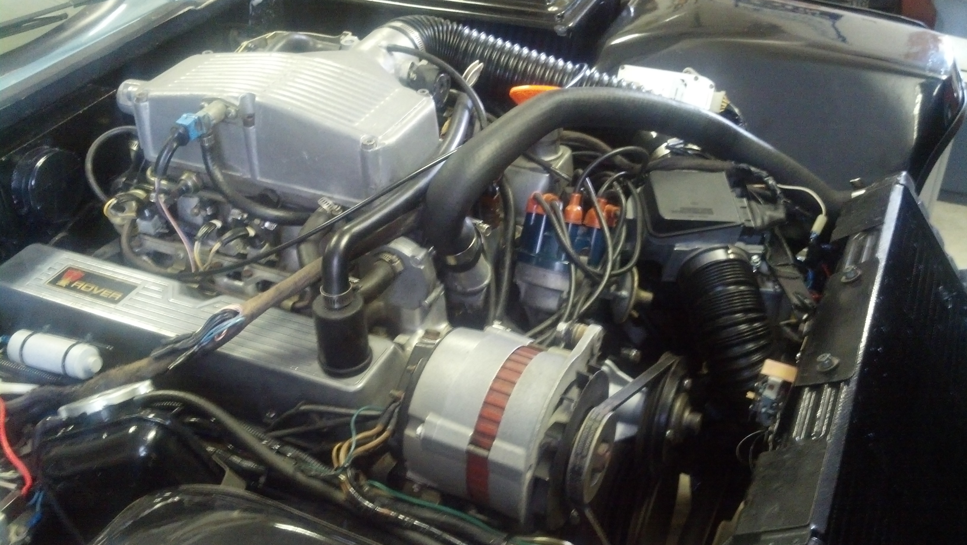

2013-03-19 by Mike Sullivan
Well the project is completed...repacked front bearings, wrapped 4 feet of exhaust piping from the cast iron manifolds, installed steering shim(s), new water pump, thermostat, cleaned, sanded, primed and painted nearly all of the frame that can be done while the body in on the vehicle, removed A/C compressor and associated equipment under the bonnet (it hadn't worked in 17 years and was R12...). New 10 way adjustable shocks installed with softer rear springs and taken for a ride (50 miles) and I will say it rides 1000% better. The shocks are wonderful and the rear softer springs seem to work.....but.. but...but
I didn't get a spanner for the shocks and I don't seem to be able to find the right one unless I want to spend nearly $100 for an adjustable / universal one....It would seem for such expensive, adjustable and high quality set of shocks that something as simple as a cheap spanner tool to adjust the ring would be included or a source identified....
Any ideas...??
Currently the shocks are at their furtherest extent and the ride height is low but not necessary unacceptable. I would like to raise it about 2" all around.
Hope that the rest of you folks had time to get their vehicles ready for the spring and another year of showing off such wonderful cars... Just to mention as I drove down the interstate there were a number of folks either taking photos or actually filming the car as I drove back home....It seemed to be more attention than I had seen in a while.

2013-03-19 by larry meadows
Mike,
I have a spanner for my shocks (Q1A) if you think it will work I can loan it to you.
What spring rate did you install on the rear?
Mike,
Be careful when adjusting the height of the ride with the shocks. you do not want the shocks to top out as it will blow the seals and void the warrantee.
Mine and the blue car of Ron's, wanted to top out and our adjustments are as long on the springs as they can be adjusted. I still get a top bump (fully extended) whenever I run over the railroad tracks.
