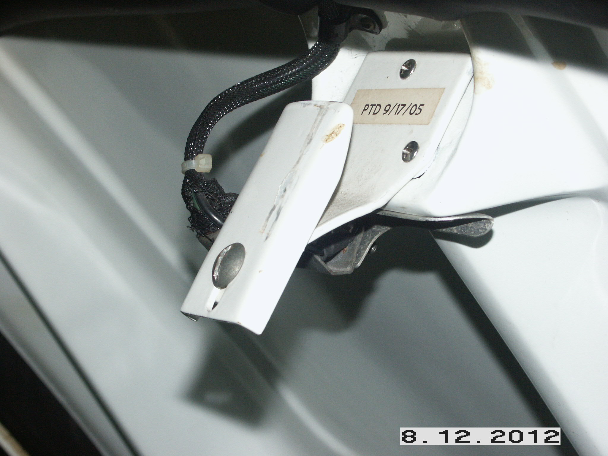

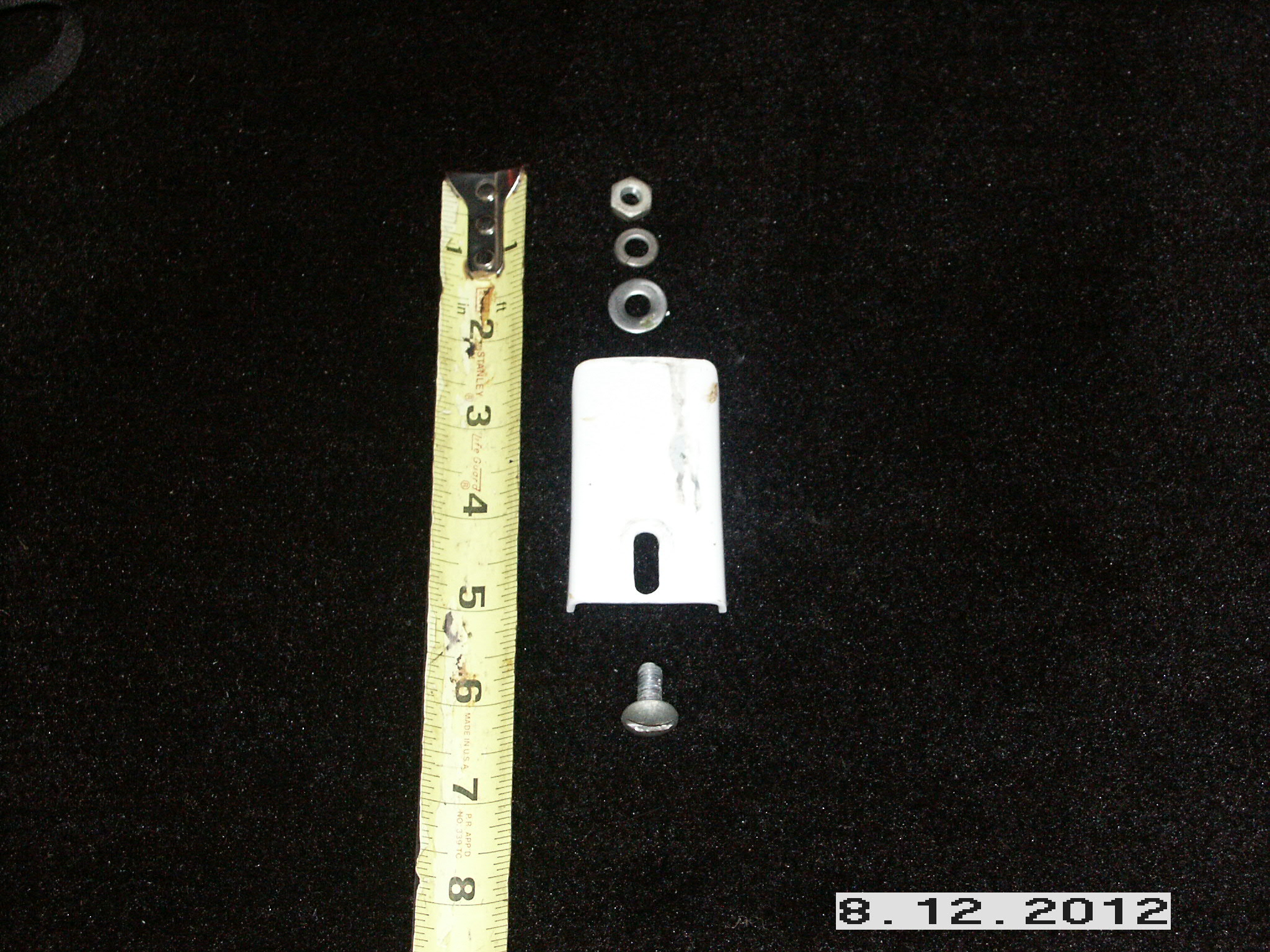

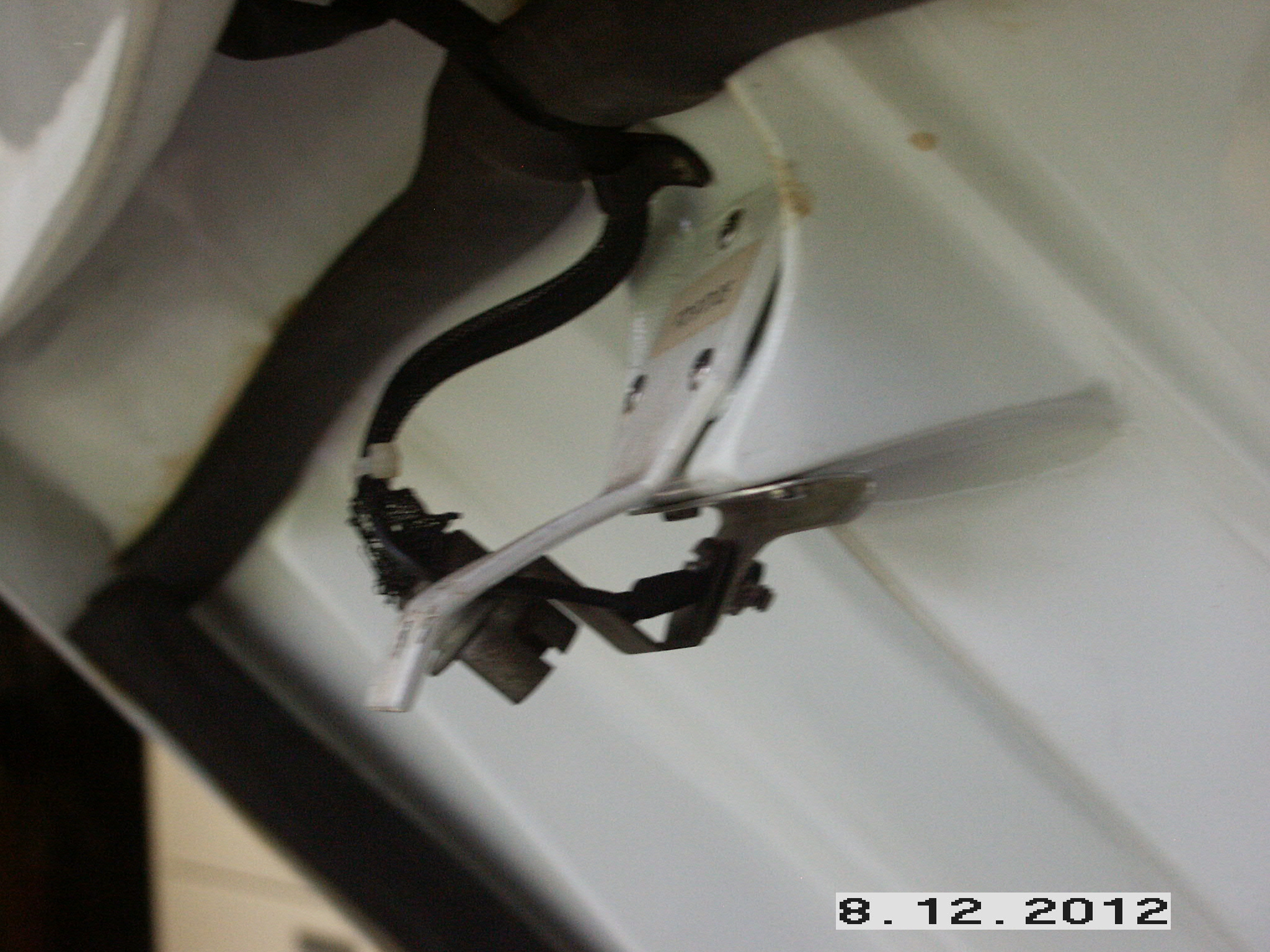

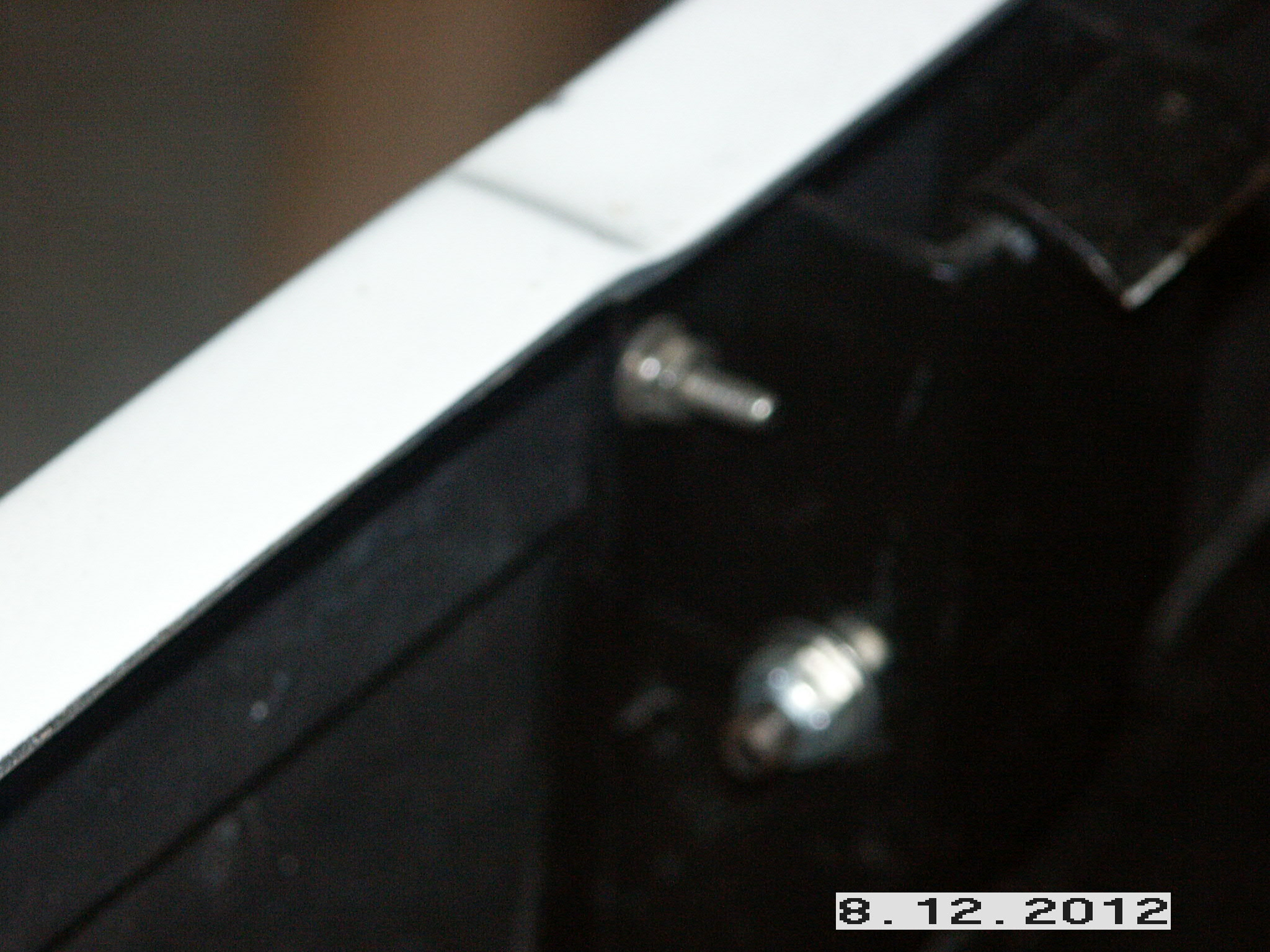

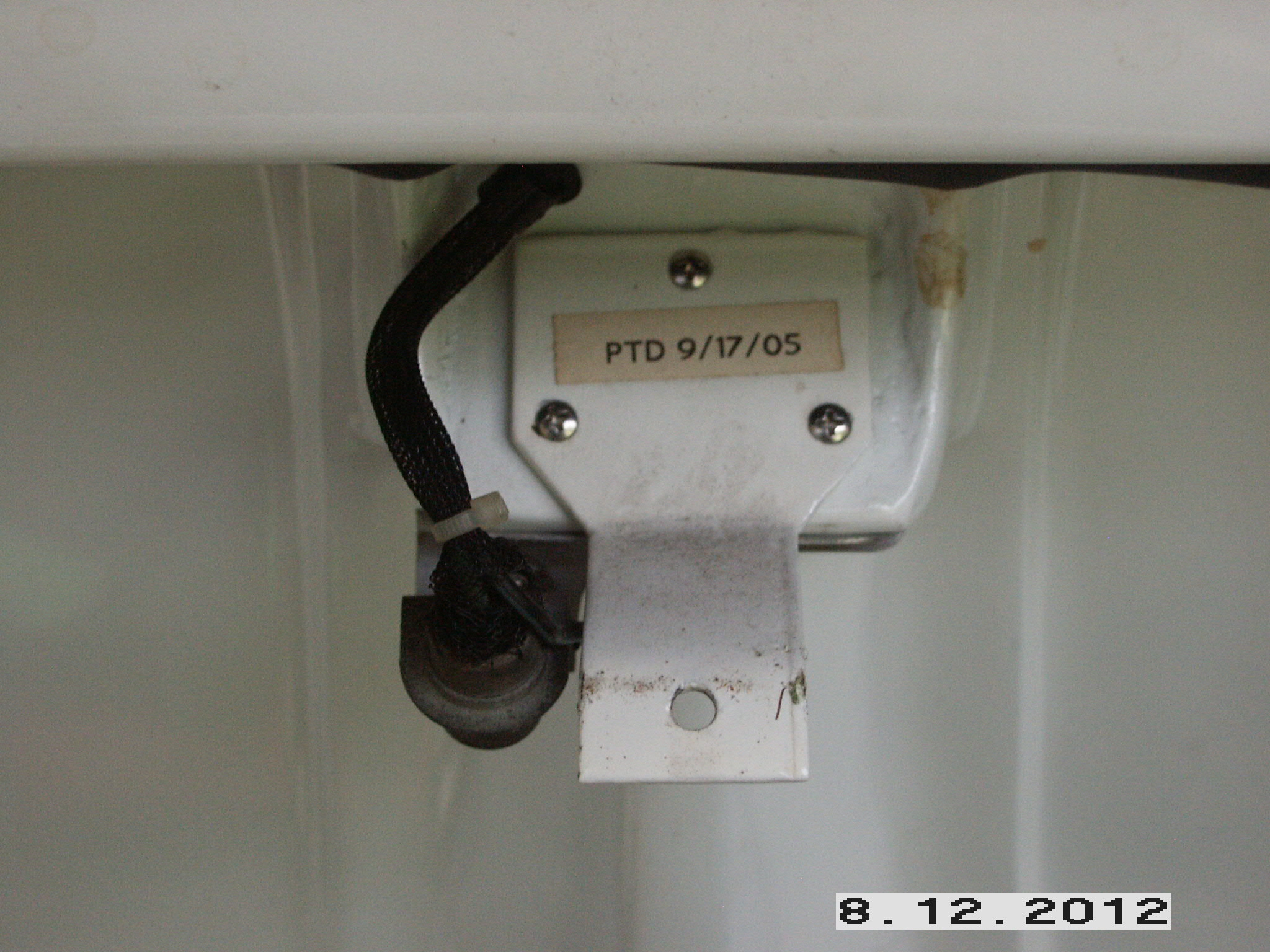

Here a couple pictures

Larry,  Not sure what I am looking at with your pictures.  The pictures show the trunk lid latch?  Attached to the trunk lid latch is?  What attaches to the MGB button that remains on the body?  On the trunk lid are there threads built in, to mount the latch? Thanks again. I need to get back there and work on the Marcos.  Having too much fun doing this research. Steve V.

There are three mounting hokes in the boot lid, I used Rivnuts in the holes but rubber 'jack nuts morm fine.
The picture of the assy. is a mount bkt and a striker (the piece shown with nut, bolt and washers is removed to show the seperate parts). The side view of the bkt alone shows the offset.

Re: Trunk/boot latch assembly
2012-08-12 by steve
Larry,  Yes the body and the trunk lid.  Steve V. Marcos in Arizona

Re: [MarcosManiacs] Re: Trunk/boot latch assembly
2012-08-12 by larry meadows
Steve,
This is a poor shot of the body side. It is a fiberglass piece with a metal latch and spring enclosed. I could make a mold and cast you a part if Rory doesn't have them. The metal latch ps a simple to fabricate part. The spring is a bit tricky, though. I can send you drawings of the latch and spring.
Oops, forgot the pic.
If you have Windows viewer, adjust the brightness and contrast to get a better view,
