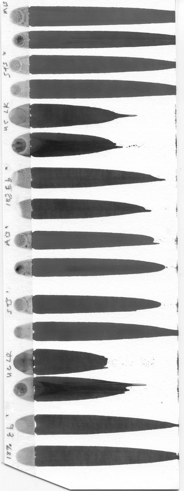

I received the WJ-1082 ink from PrinterFillingStation and did a draw down to compare it to Eboni V1.1. I placed a strip of packing tape at the top of a sheet of Arches hot press, placed a few drops of each ink on the tape, spacing them so they won't run together. I used a glass rod to pull the inks down the paper. After drying I measure: Eboni V 1.1=31.89, 0.72, 1.57; WJ-1082= 31.23, 0.67, 1.49. The Eboni shows mottling, the WJ-1082 does not. I did 3 draw downs, the numbers are all about the same and the mottling/not mottling is the same. Interesting.
BTW the 4800 lays down more ink than this. Eboni V 1.1 on Arches HP, Lab=21.44 at boost 100%.

​There are a number of variables in what might be behind the differences.
In the recent draw-down I did of LK density inks, an 18% wj1082 from STS was included. It might be said to be mottled, and this was on inkjet paper. Arches has a much more uneven absorption. I recommend matte inkjet paper for these draw-down tests. For a grayscale version of my complete draw-down, see http://www.paulroark.com/BW-Info/LK-Draw-Down-4-1-2016.jpg . The labels are probably self-explanatory. I might add that I've seen some variability in product from STS also, though it's not what I'd call unacceptable.
As I noted previously the Epson EcoTank carbon may set the baseline for these third party vendors.​ However, in my testing of that product against Eboni/wj1082, I thought the Eboni/wj1082 was better for my uses.

I know Paul Roark does draw downs to measure the color and density of different inks. It might be a quick test to see what an ink does without loading a cartridge and printing with it, but I don't think draw downs (or simply measuring the 100% patch in calibration mode) can accurately illustrate the possible density with a given ink because the paper will actually lose density as it is flooded with ink. To get a clearer understanding of what an ink is capable of just print the black channel from the ink separation image and measure and graph each patch (after force drying it for 2-3 minutes).
I haven't tested the Epson Hot Press, but I've measured countless ink separation images over the last few years. I've been doing tests all day today with Canson Edition Etching shows that the STS Matte Black (v1.1) reaches 1.71 at 30% and a Dmax of 1.73 at 65% before falling back down to 1.56 at 100%. I've included a series of Lab_L measurements of the black channel's ink separation image as an example, but after checking a handful of measurement files I keep for different papers, they all exhibit similar densities for the black channel.
96.93 46.98 38.75 27.95 21.46 18.81 17.50 16.67 16.30 16.14 15.93 15.82 15.72 15.72 15.65 15.63 15.71 15.92 16.41 16.69 17.24
Take a look at this post I wrote a few years ago. The graphs can illustrate what I'm talking about here: Comparing Cone Piezography Shade 1 and MIS Ebony Shade 1. The post uses the old version of the MIS MK, but I have STS MK v 1.1 in the K channel now. I will do an updated post with the new ink at some point... I don't have a full set of the v 1.1 inks here, but I do have some clear base on hand I could use to mix up the STS MK. We'll see how distracted I get this week...

I agree that the draw down is just a quick test. It can, however, provide a lot of information, including on a per hour and expense basis. Labs use these types of tests all the time.
Be aware that STS MK that is sold in their carts is not wj1082. As far as I know they only sell the "Image Specialists" (now a part of STS) "WJ" products at larger volumes and not off their web page. (Image Specialists' founder/chemist who was behind the products, but died, was "Walt.")
