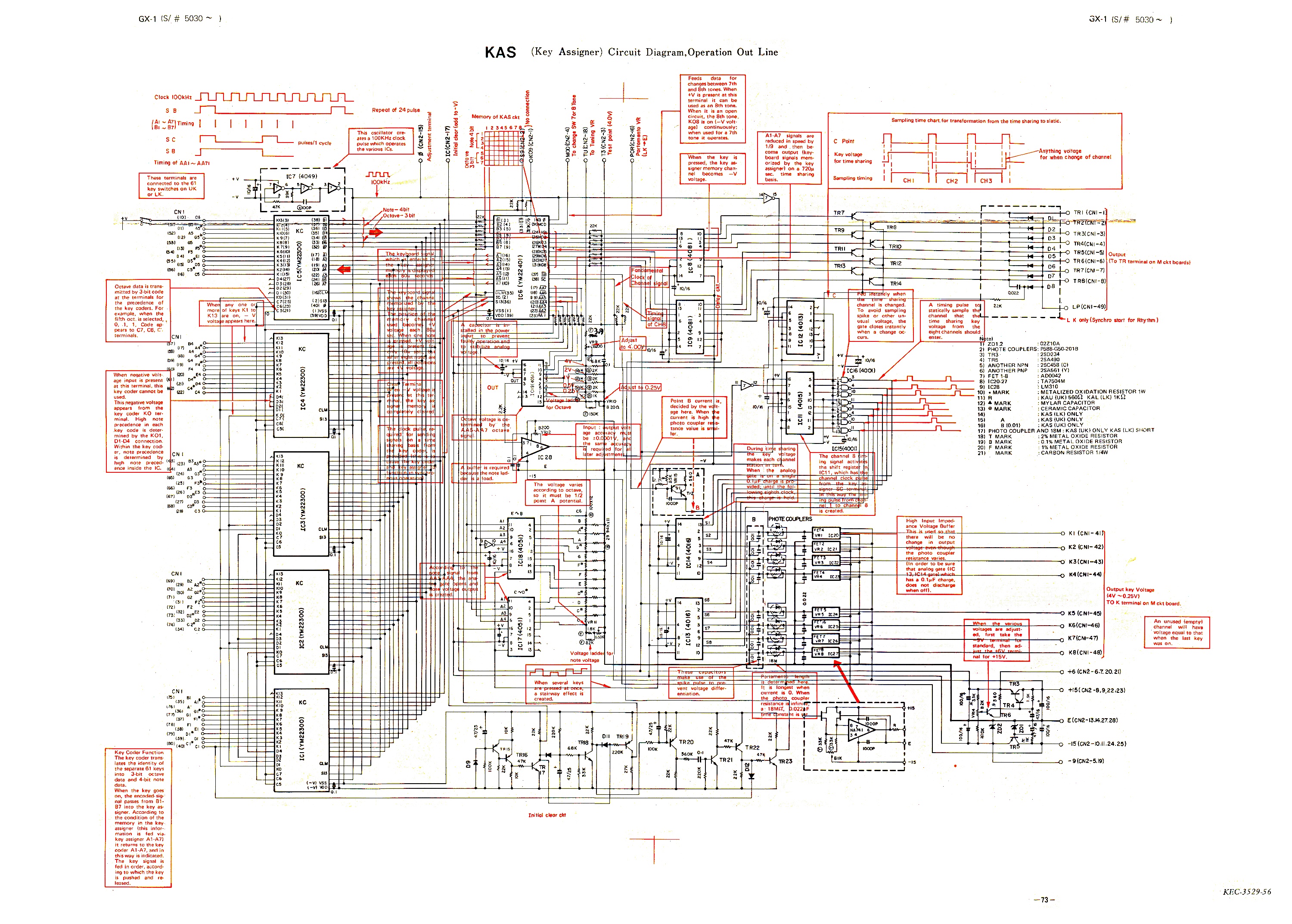

Re: [yamahacs80] CS80 in NHK TV program
2014-07-04 by laurie
Voice 8 on both panels will not sound in rotation on any working CS80 unles you hold a finger down before you  press another key which will be 8 ....
you will get 1234567 1234567
but if you go 12(3-hold) next one is 8   4567
the 123 order only works on start up....
as soon as you play a chord the order changes....
voices do rotate in both sustain modes...
---- On Fri, 04 Jul 2014 11:37:21 -0500 Daniel Forró danforcz@... [yamahacs80] <yamahacs80@yahoogroups.com> wrote ----
2014-07-04 by Phil a
Thanks Laurie, this is what I meant. If you always heard 1 voice was silent simply means it was one of the first 7 voices.
Phil
2014-07-05 by Daniel Forró
Thanks for info, I didn't know. Who knows why key assign algorithm is like this, maybe some kind of technical limitation? I don't see any logical reason why on 8 voice instrument one voice shouldn't play except when 8 keys are pressed.
But anyway it's strange, because if there's only 7 voices playing, and one voice card doesn't work, then each 7th press of the key will not sound, I suppose. On my CS each 8th didn't sound.
Daniel Forro
The 7 voice rotation appeared on the GX1 poly ranks.
The GX has a switch mounted inside to disable the use of the 8th voice, even
if multiple voices are in use.
The aim of that was to allow you to continue using the synth even if a voice
card failed - you could just swap the bad card into the voice 8 position and
set the switch to 7 voices.
I don't know if the CS has the same option, it may be they just used the
logic straight from the GX KAS chips.
Another benefit of the 7 voice rotation is that minor differences between
the sounds of each voice card don't tend to cycle so obviously.
Cheers,
Colin

RE: [yamahacs80] CS80 in NHK TV program
2014-07-05 by Colin f
> No, the reason was because the chip was designed from organ
> tech. The 8th channel was assigned to the pedal board.
An organ pre-dating 1974 with dynamic allocation of voices ?
Are you sure ?
The GX service manual clearly shows the purpose of the SW 7or8 Tone input is
to disable allocation of voice 8 on the YM22401 KAS IC.
Cheers,
Colin
2014-07-05 by David Rogoff
On Jul 5, 2014, at 8:58 AM, Kent spong kent_spong@... [yamahacs80] <yamahacs80@yahoogroups.com> wrote:
> No, the reason was because the chip was designed from organ tech. The 8th channel was assigned to the pedal board.
I’ve heard that explanation before but I don’t understand how that would work given the KAS logic.
David
> I've heard that explanation before but I don't understand how
Indeed.
The information I have is that Yamaha designed the GX key assigner
independently but at the same time as E-Mu, who got a patent on theirs in
1974.
It is clear the intended purpose of the GX KAS chipset was purely to drive a
fixed number of linear VCOs.
You can see the annotated service manual page here:
http://www.colinfraser.com/GX1-KAS.jpg
Cheers,
Colin
