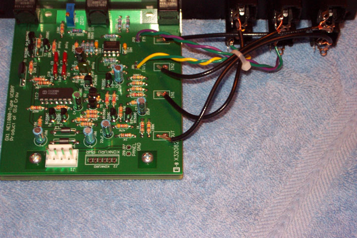

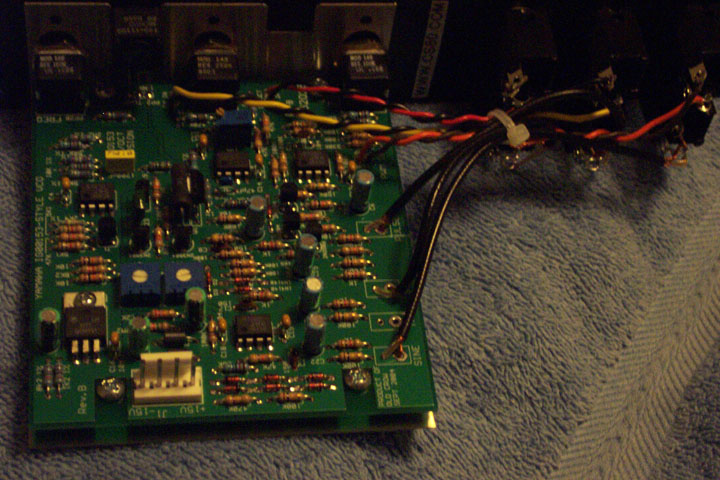

Here is a quick recap of the VCO153 and GX1BPF:
VCO panel:
http://www.cs80.com/CSVCO153_FPD.pdf
VCO board (through hole prototype)
http://www.cs80.com/CSVCO_PCB.jpg
VCF panel:
http://www.cs80.com/GX1BPF_FPD.pdf
VCF board (through hole prototype)
http://www.cs80.com/GX1_BPF_PCB.jpg
One difference between the prototype and production models, aside
from lots of SMD parts, is the use of a small "jack board" soldered to
the PC pigtails of the Switchcraft 112PC jacks that connects to the main
board with a short ribbon cable. This allows me to keep everything in a
ground plane and remove a lot of tedious point to point wiring at the
same time.

Re: [yamahacs80] 5U modules
2011-11-15 by b3groover
Those looks really great! Any estimate on price yet?
Thanks!
----Jim
2011-11-15 by David Rogoff
> The Old Crow <mailto:oldcrow@...>
> November 14, 2011 9:25 PM
> VCO panel:
Excellent! One thing (of course) - one of the coolest effects on a CS
is bending chords down to dc, which is possible since the VCOs are
linear, not exponential. I hope the FM input jack will allow this.
Maybe 0 volts is freq * 1 (no mod), +5v is freq * 2 (+1 octave) and -5v
is freq * 0. This would work like the ribbon on the CS80/60.
David
