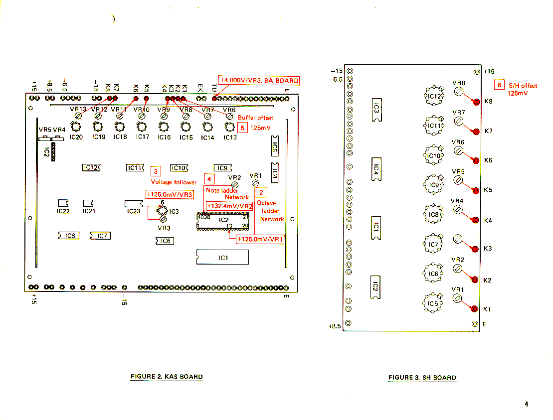

Next question:
I have tuned voices 1 ... 7 in section I for 0 Cent at middle C, in 8"
footage. (I ignore voice 8 for now.)
I notice that the adjacent C#, as well as the C one octave higher, are more
than 10 cent off.
Same (but opposite direction) when I go down one octave.
As this is consistent for voices 1...7, and happens in *steps*, I conclude
that there is an adjustment off on the KAS board - right?
JH.
Re: [yamahacs80] Tuning questions (2)
2008-01-05 by JH.
Bingo!
Offset adjustment of Voltage follower (VR3 KAS board) was slighly off.
Adjusted it, and that nasty step between C and C# is gone!
JH.
2008-01-05 by The OldCrow
Hi JH,
Check the DAC span and zero on KAS.
http://www.cs80.com/docs/adjustment/cs-80_adjustment_procedure_04.gif
Scott
