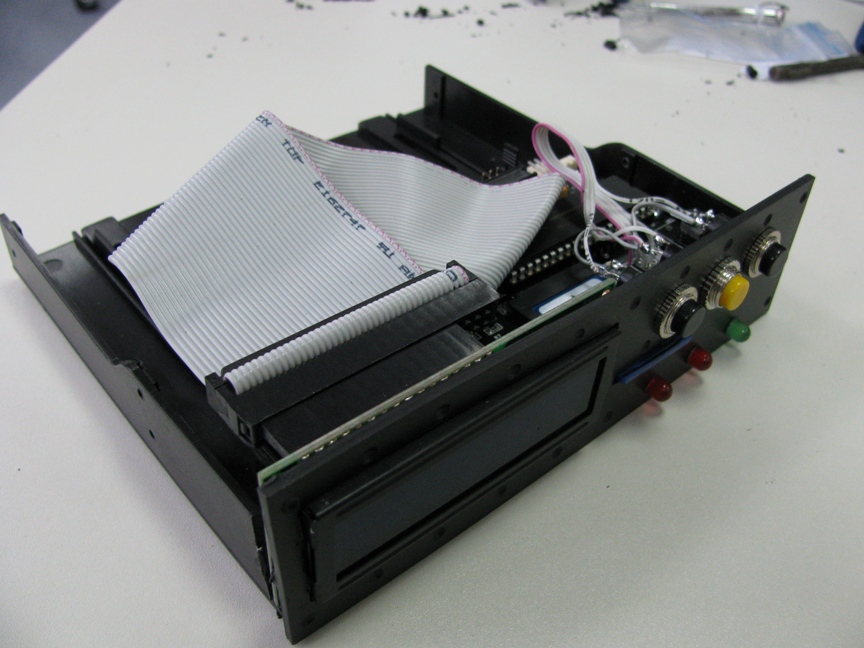

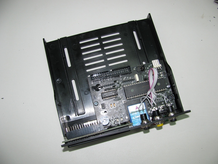

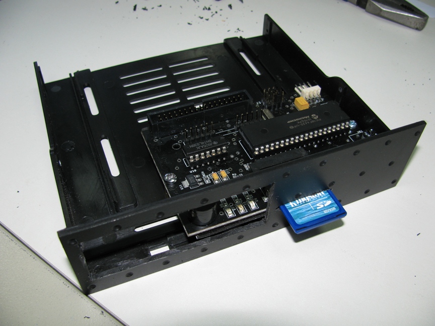

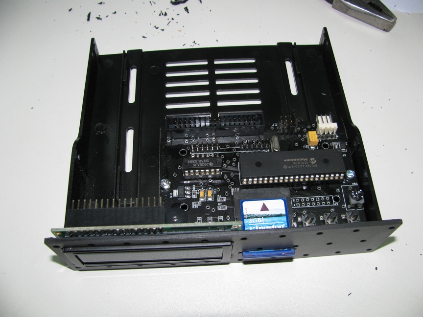

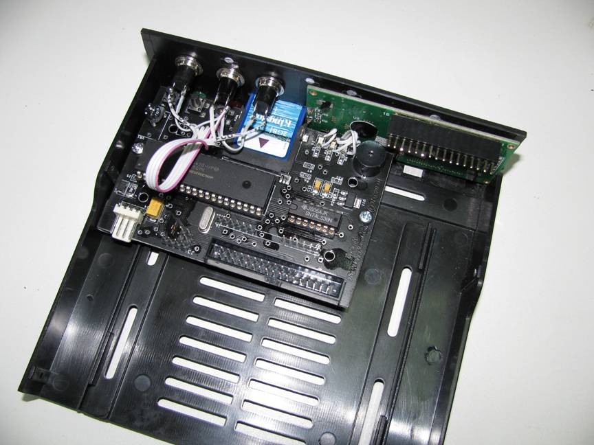

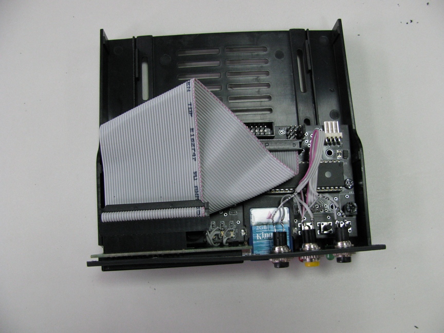

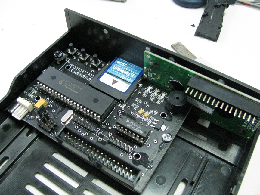

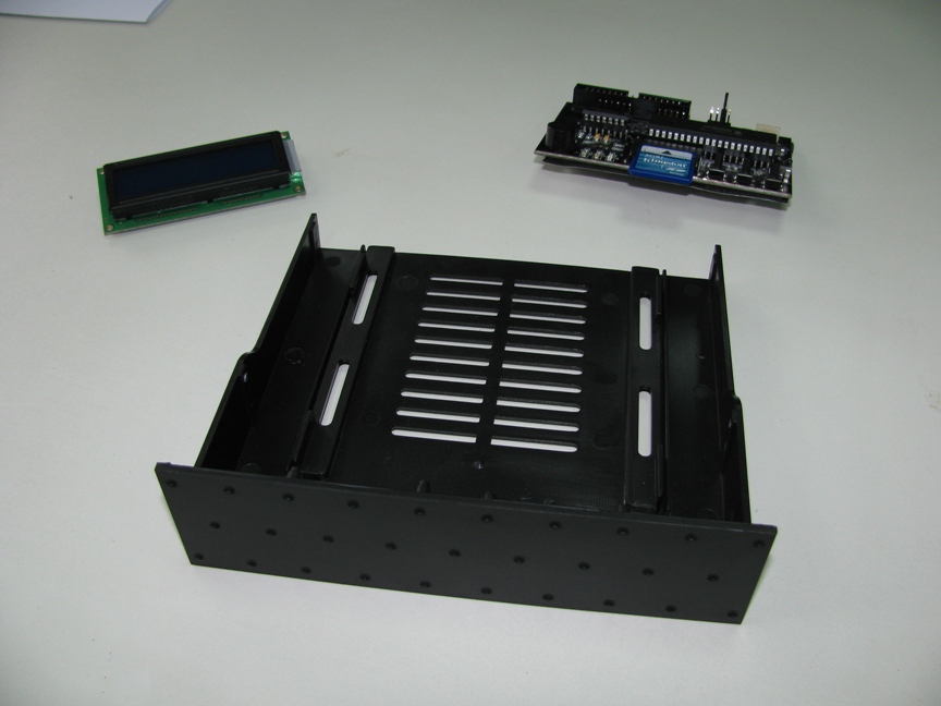

Well I've finally done with HxC installation. After some time of thinking do I really need it in addition to Mac setup I decided to speed up booting and OS response time and make it more reliable. This time I used production version of HxC floppy emulator (revB) but my DPX-1 still has own prototype installed. Sure, nothing could happen without E-Synthesist support and helping in preparing disk images.
So, there are no problems from technical side, however HxC PCB layout is not very good for 5.25 mounting. You need the case, remote mounting for LCD, buttons and LEDs.
For the case I used plastic blanking cover from PC. I don't know how to find the same but it's general idea. I tried metal covers also but using plastic one is simpler. Then new buttons, new LEDs and the part of IDE cable for LCD connection. That's it.
Photo report is bellow:

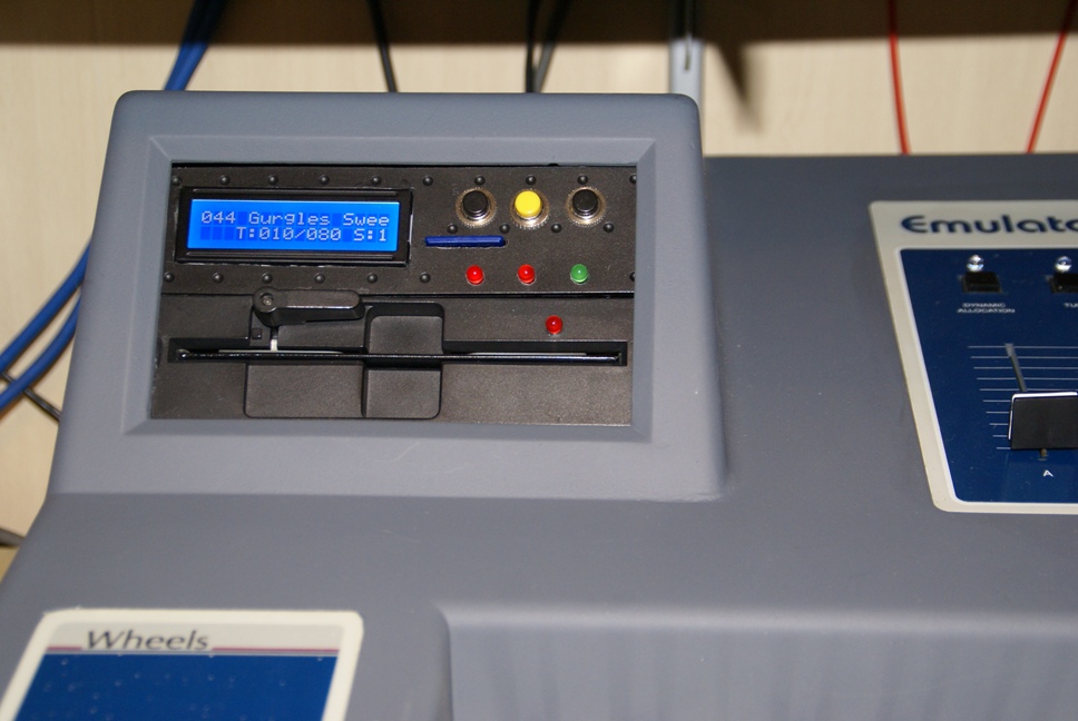

And the result:
http://www.deftaudio.ru/files/EII/DSC07080.JPG
You see I'm not the mechanical engineer )))) Medium soldering skills are needed to complete this project. And you must be careful while sawing the plastic.
Issues... some... may be only one. HxC floppy emulator has an option to boot the last image on power on. If this option is enabled then during power on EII informs you about wrong diskette. I think the problem is that EII inits faster than HxC completes image loading.
You just need to switch to another image and it will boot fine. E-Synthesist, do you have the same with HxC standalone?
Andrei.

Hi,
This looks great.
Can you give a little bit more details how to "remote connect" other buttons and LEDs to the HxC ? For the LCD it is quite simple, because the HxC (rev C...) already has an array of pins for using a ribbon cable.
Also... if you can give a hint on where this kind of plastic housings can be found, that would be great too !
The automatic load issue of the most recently used floppy disk image is a known issue on the E-II.
After booting the EII, the EII will report a missing or bad disk, but by selecting an image with the buttons on the HxC, the E-II will boot and from then on the HxC can be used as if it were a floppy drive.
Jeff knows about the boot issue and he was going to have a look at it.
I'll have to contact him about the status... He was also working on the write-support which would allow for saving banks on the EII, but I didn't hear from him neither about this activity.

Hi E-Synthesist,
Both revB and revC have the same front panel connector
http://www.deftaudio.ru/files/EII/frontpanel.png
I used pins 7,8,9. these are for buttons. for LEDs I directly soldered to existing LEDs even without removing them.
hint )
this cover came by default in external enclosure by AgeStar:
http://www.agestar.com/english/products/sub5a1.asp
Andrei.
> > Andrei.
