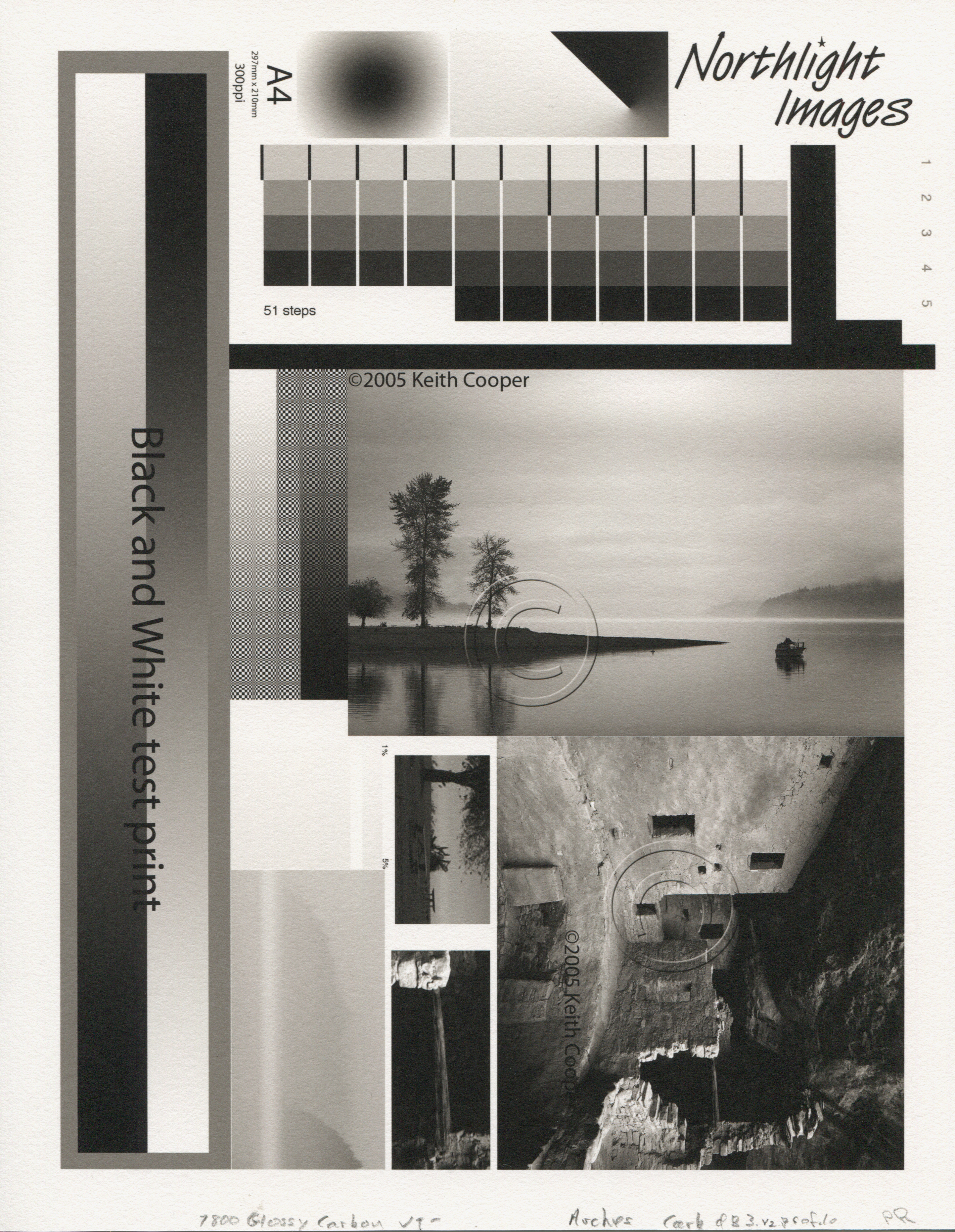

Mike,
This is a 300 dpi RGB scan of the Northern Light test image:
The print was on a letter size piece of Arches, using the "dB3, v.2" profile, which has a total delta B from paper base to max. Lab B of about 3.5.
(So, this is not the dB2 profile shown, but that on letter size that one is a bit of a stretch for that target. The black (MK) dithering and paper patterns in the midtones are going to interact with the gradients and leave artifacts.)
Keep in mind that I am targeting Arches full sheets -- 22 x 30 inches. So, on this letter size, unsharpened (cheap) flatbed scan, you'll see a lot more impact on the image from the medium than I would someone looking at a large print. (You'll also see dust on my scanner.)
The image was gray gamma 2.2. So, in printing I applied my conversion curve. This compresses the dark end. While the flatbed didn't separate the bottom row of Keith's 51-steps very well, my spectro does, and the dark end will get a bit darker as the MK cures overnight. That is, there is appropriate separation there even if the scan does not show it.
BTW, I use the dB3 carbon core for what I consider the best Neutral profile, not the dB2 core. But for many images, where someone wants the most archival full sheet Arches print, the dB2 carbon profile can do a very good job.
FWIW
Paul

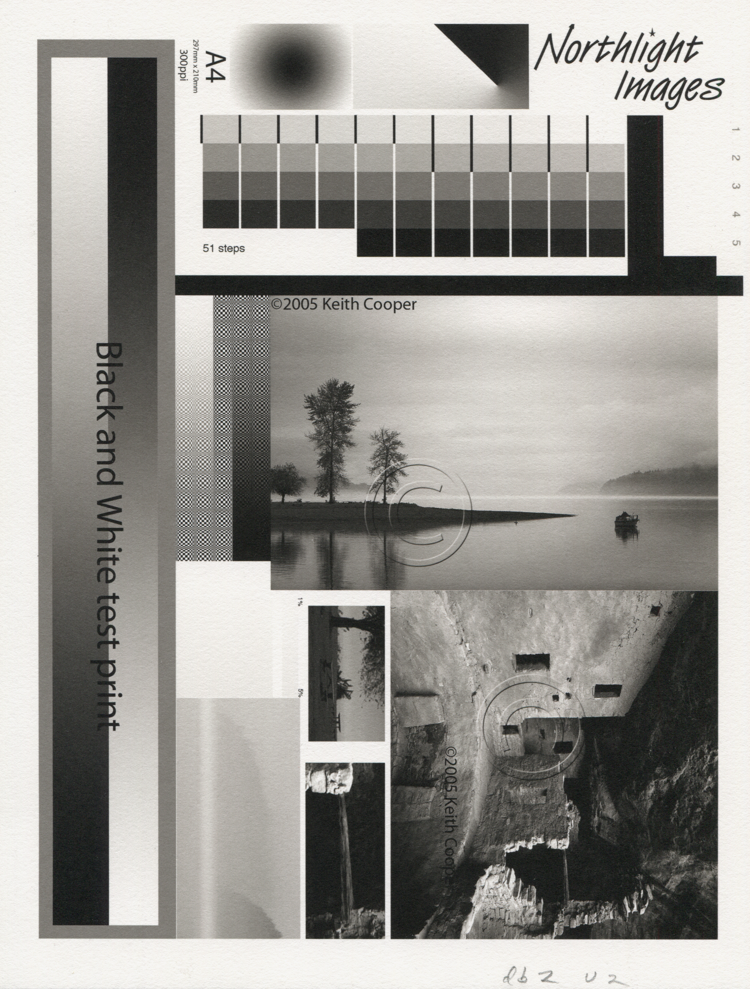

The "delta B = 2" Northernlight test image on Arches is posted here:
The artifacts I was trying to trace down are visible in the top, small circular gradient. The non-linearity appears to be an artifact of linearization that just shows up worst in the black ink and small, high contrast gradients. I have been unable to trace the exact cause(s). They show up in a 2 inch print using a linearized Black Only profile gradient, but not in a 6 inch print, even when the 6 inch gradient is compressed to 2 inches after it is scanned. They do not show up in the un-linearized profile gradient. I have never seen evidence of this artifact in actual pictures.
At any rate, I think from the posted scan of an 8x10 image, one can get an idea of what a full sheet Arches 100% carbon print made this way would look like. On the wall, with a natural paper mat board, an image made with this "dB2" profile is going to look simply like a neutral B&W print.
This "glossy" carbon inkset is turning out to have abilities I did not expect.

Thanks Paul - it looks pretty good to me.  It will be nice to be able to print matte and glossy from the same ink.
